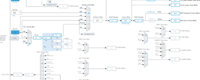

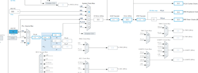

#endif /* USE_FULL_ASSERT */Clock setup:
2025-06-04 12:41 AM - edited 2025-06-04 12:42 AM

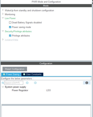

For the testing I have cleaned all GPIO and peripheral pins but current consumption is 180uA instead of approx. 110uA as you can see in the datasheet (table 28).
Power settings:
Clock settings:

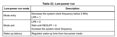

2025-06-05 4:24 AM
> HAL_PWREx_EnableUltraLowPowerMode();
> this function is used to enter in low power mode. right?
Let's look at the source and find out:
* @brief Enable Ultra Low Power BORL, BORH and PVD for STOP2 and Standby modes.
* @note All the other modes are not affected by this bit.
* @retval None
void HAL_PWREx_EnableUltraLowPowerMode(void)
SET_BIT(PWR->CR3, PWR_CR3_ENULP);
}It sets ENULP.
To enter low power mode, based on the table above, we need to set LPR=1.
So no, that doesn't get you there.
You want HAL_PWREx_EnableLowPowerRunMode.

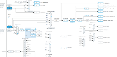

2025-06-05 8:51 PM
Thank you so much for the guidance. I have tried it by replacing HAL_PWREx_EnableUltraLowPowerMode to HAL_PWREx_EnableLowPowerRunMode but it does not seems to lower the current consumption.
I have not changed anything else in .ioc file or any other configuration. My current consumption while in runmode is still near 420uA. note that I have connected 1k resistor with LED and I am not using inbuilt LED of nucleo-board. In stop 2 mode, controller consumes approximately 150-160uA.

Where did you decrease system clock frequency below 2 MHz?
2025-06-08 8:18 PM
Sorry for delayed response, I have changed MSI clock frequency to 800kHz and passing it to SYSCLK. So, my system clock frequency is 0.8MHz already.
Please, refer to the screenshots and .IOC file attached. @KDJEM.1 @LPetr.1 @Tesla DeLorean @waclawek.jan
you guys have any idea what is going wrong ?
Thank you so much in advance.
