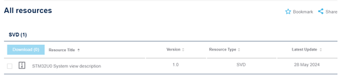

Hello @Stephan W. ,
Now, the STM332U031 SVD file is available in CAD resources.
Thank you for your Contribution in STCommunity.
Kaouthar

Hello @Stephan W. ,
Kaouthar
