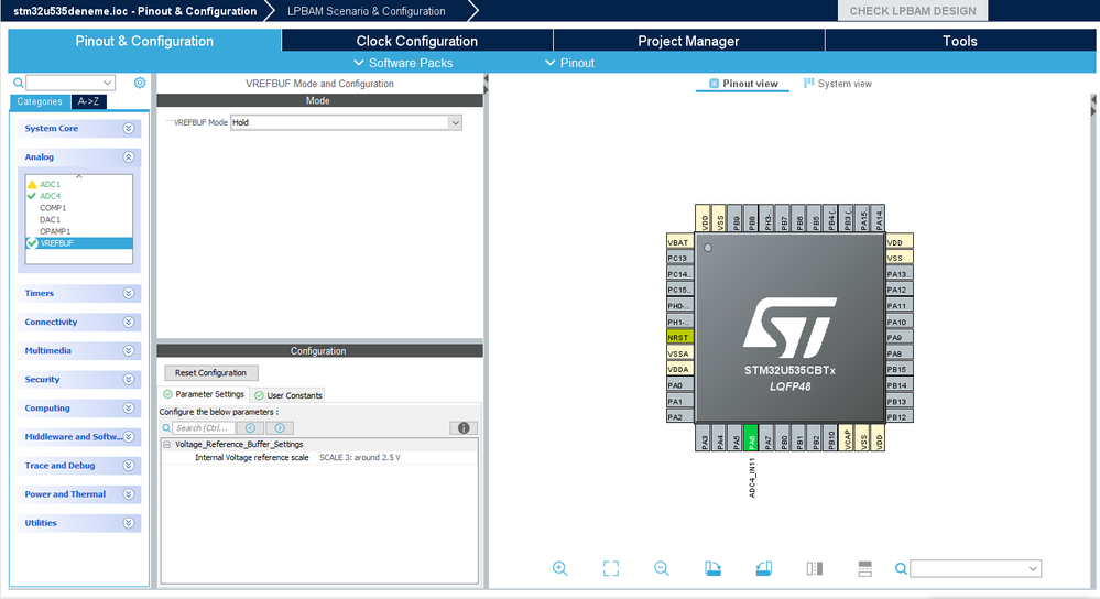

If we adjust Vrefbuf as HOLD to 2.5V, does the adc have 2.5V reference voltage? Some of the code is attached.

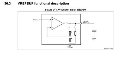

see U535 maual:
But VREF+ is not on a pin on your chip. So - what then ??
