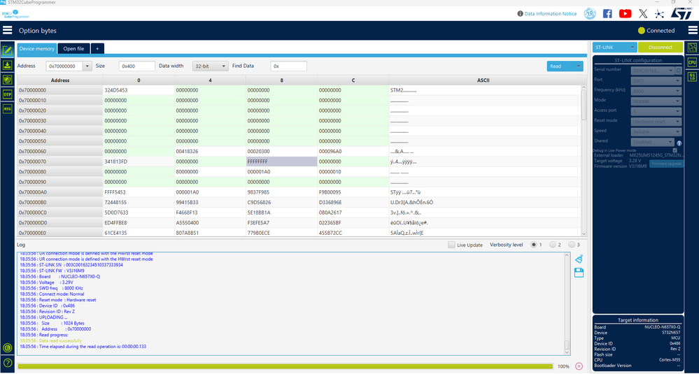

I followed the steps in this demo workshop to upload a simple program to toggle LEDs to the Nucleo-N657X0 board. The project is in FSBL. I can run the code in debug mode and upload the signed program to the external flash on the Nucleo-N657X0 board with STM32CubeProgrammer. However, when I tried to run the code with the 'Run after programming' option, I got the warning that the core is locked up. Besides, the Option Byte tab and the Erase tab are gone when the ST-Link is connected (See figure below), so the commonly suggested fix of modifying Option Byte is not possible..

I wonder if there a register that I can check to see the state of the MCU? Is it something to do with the Secure Programming? Any suggestions and comments are greatly appreciated!
