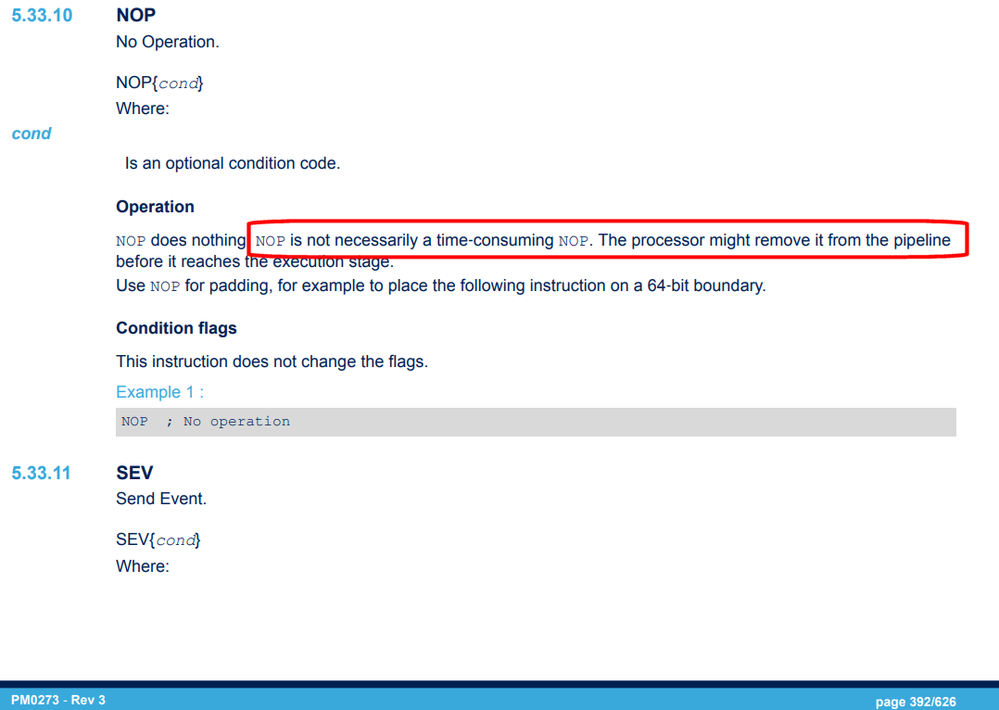

@acapola wrote:how I measure execution time such that I get 1 cycle difference when I insert a nop in the measured code ?
You're working on a false assumption there - Inserting a NOP does not necessarily cause a 1-cycle difference:
