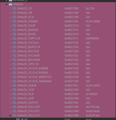

I'm trying to use the LTDC peripheral with DMA2D to be able to send a image to the display without using the CPU
So first i used the example LTDC_Horizontal_Mirroring to have a working LCD . Compiling it i have the dolphin on my screen and flip horizontally.
Next step i used the same config as the project DMA2D_MemoryTo_Memory. So DMA2D in M2M, ARGB4444 in input /ouput alpha input at 0xFF and enable the interrupt (done in my LTDC_Horizontal_Mirroring project)(Also enable I and D cache for cortex M55).
After i used the same code for the dma in the M2M project , but when i use the debug tool or put the ouput buffer in my screen i have only 0.
I checked all register for DMA and the config and adress for in and out (DMA) correspond to the address of the buffer i gave to DMA.
Any ideas ?
Thanks.

2025-03-28 11:18 AM
For info here all registers
