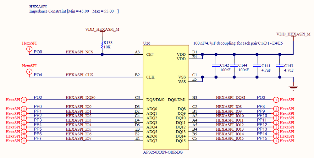

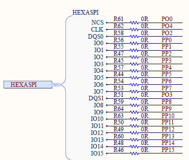

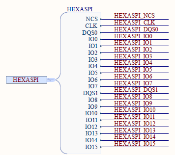

Hey @ov
Here is another STM32N6 specific design from the DK reference design, using the HEXASPI.
To RAM:
To STM32N6:
Ref: https://www.st.com/resource/en/schematic_pack/mb1939-n6570-c02-schematic.pdf

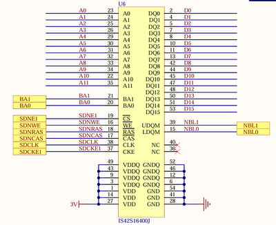

2025-05-01 5:58 AM
Here's 64 MB SDRAM routing on an STM32F4 chip. Chip family doesn't change much here, signals are the same.
https://www.st.com/resource/en/schematic_pack/mb1075-f429i-e01_schematic.pdf
