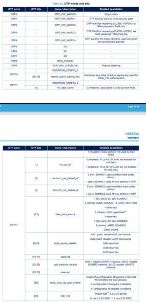

I want to change for boot to use XSPI1 interface, but I am not sure about OTP bits, there in description some bits is not very clear, what OTP bits to set to switch if it's possible ?
Additionally if I will use SD card for boot I can set OTP11 value to 0x00000020 (bit5 = 1 = sdcard), write FW to sd and use sd for boot source ?
Thanks.

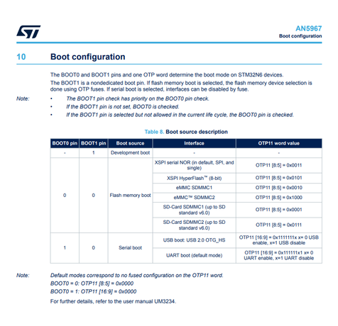

The OTP configuration depends on the source.
If a flash boot is selected, the firmware is loaded from an external flash memory. The flash source selection is done through BOOTROM_CONFIG2 - OTP_WORD11[8:5] = boot_source (4 bits). The possible sources are listed below:
• XSPI serial NOR (in SPI mode, single)
• XSPI HyperFlash™ (8-bit)
• e.MMC™ SDMMC1 or e.MMC™ SDMMC2 (up to JEDEC v5.1)
• SD-Card SDMMC1 (up to SD standard v6.0)
Fore more information for OTP configuration, I recommend you to look at AN5967 section 10 Boot configuration and at UM3234 Table 22 you can find more details about the boot configuration.

In Flash Boot (OTP11 flash_boot_source=0) , the BootROM uses always XSPI1 with XSPIM Port2 in SPI legacy mode MOSI/MISO, this is hardcoded. XSPIM-Port2 is the boot peripheral and we recommend to connect external serial flash on it.
Refer to UM3234 in section 3.4.5 XSPI / XSPIM configuration for serial NOR device. and 3.12.3 Configuration of ports and pads.
