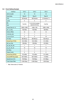

In the case of STM32N6, and according page 82 of the IMX219 datasheet table "clock setting example", only the 3rd column is relevant since STM32N6 supports 1 or 2 data lanes but not 4. In that case the D-PHY bitrate has to be set to 912 Mbps. In the case of IMX219, 912 Mbps is the maximum you can get from the sensor and on 2 lanes. With 912 Mbps, clk_byte is 114 MHz
