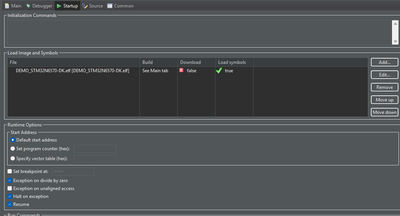

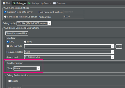

I use the following approach for the XIP configuration.
The FSBL is without changes.
In the Appli code, in main.c, add code as shown below. Make sure that the debugger does load symbols from Aplpli ELF only, and does not download the firmware, and does not reset the chip (see the pics below).
Now you can power up (or reset) the board after flashing, run the Appli debug, set breakpoints and press the USER1 button to debug.
BSP_PB_Init (BUTTON_USER1, BUTTON_MODE_GPIO);
// loop that can be used to catch the application for debug.Set mini to 1, build and flash target as normally.
// Set BOOT1 switch to the left position, press reset without removing cable.
// Use the Connect to running debug config to connect, then change mini value from watch.
// For breakpoints to work they seem to need to be manually changed to ahrdware breakpoint
static volatile int debugFlag = 1;
while (debugFlag == 1 && BSP_PB_GetState(BUTTON_USER1) == 0)
__NOP();
/* USER CODE END 1 */
