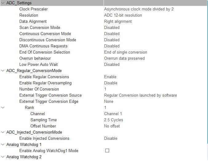

}This is my ADC configuration
2020-11-20 11:27 AM
I solved the problem changing the clock from asynchronous to synchronous. Maybe something went wrong in clock initialization. I can not understand what.
