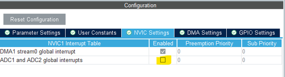

You didn't enable the NVIC for the ADCx

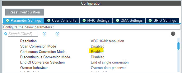

I would disable Continuous Conversion Mode.

2025-07-12 12:17 AM
Thank you for your feedback, I tried the methods you mentioned but did not get any positive results.
