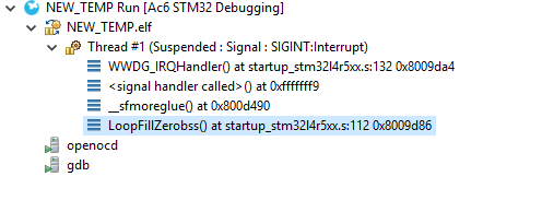

Archive addition leading to Reset.
Now its failing in SystemClock_Config.
And entering to WWDG_IRQHandler() at startup_stm32l4r5xx.s:132 0x8009dc0
Failing at
RCC_OscInitTypeDef RCC_OscInitStruct = {0};♯♯♯♯♯♯♯♯♯♯♯♯♯♯♯♯♯♯♯♯♯♯♯&sharpin Debug After completing the above 2 lines enter to reset♯♯♯♯♯♯♯♯♯---->>>>>>>>>>>/* Enable voltage range 1 boost mode for frequency above 80 Mhz */ __HAL_RCC_PWR_CLK_ENABLE(); HAL_PWREx_ControlVoltageScaling(PWR_REGULATOR_VOLTAGE_SCALE1_BOOST); __HAL_RCC_PWR_CLK_DISABLE();/* Enable MSI Oscillator and activate PLL with MSI as source */
RCC_OscInitStruct.OscillatorType = RCC_OSCILLATORTYPE_MSI; RCC_OscInitStruct.MSIState = RCC_MSI_ON; RCC_OscInitStruct.MSICalibrationValue = RCC_MSICALIBRATION_DEFAULT; RCC_OscInitStruct.PLL.PLLState = RCC_PLL_ON; RCC_OscInitStruct.PLL.PLLSource = RCC_PLLSOURCE_MSI; RCC_OscInitStruct.MSIClockRange = RCC_MSIRANGE_6; RCC_OscInitStruct.PLL.PLLM = 1; RCC_OscInitStruct.PLL.PLLN = 60; RCC_OscInitStruct.PLL.PLLR = 2; RCC_OscInitStruct.PLL.PLLQ = 2; RCC_OscInitStruct.PLL.PLLP = 7; if (HAL_RCC_OscConfig(&RCC_OscInitStruct) != HAL_OK) { /* Initialization Error */ while(1); } /* To avoid undershoot due to maximum frequency, select PLL as system clock source */ /* with AHB prescaler divider 2 as first step */ RCC_ClkInitStruct.ClockType = (RCC_CLOCKTYPE_SYSCLK | RCC_CLOCKTYPE_HCLK | RCC_CLOCKTYPE_PCLK1 | RCC_CLOCKTYPE_PCLK2); RCC_ClkInitStruct.SYSCLKSource = RCC_SYSCLKSOURCE_PLLCLK; RCC_ClkInitStruct.AHBCLKDivider = RCC_SYSCLK_DIV2; RCC_ClkInitStruct.APB1CLKDivider = RCC_HCLK_DIV1; RCC_ClkInitStruct.APB2CLKDivider = RCC_HCLK_DIV1; if(HAL_RCC_ClockConfig(&RCC_ClkInitStruct, FLASH_LATENCY_3) != HAL_OK) { /* Initialization Error */ while(1); }/* AHB prescaler divider at 1 as second step */
RCC_ClkInitStruct.ClockType = RCC_CLOCKTYPE_HCLK; RCC_ClkInitStruct.AHBCLKDivider = RCC_SYSCLK_DIV1; if(HAL_RCC_ClockConfig(&RCC_ClkInitStruct, FLASH_LATENCY_5) != HAL_OK) { /* Initialization Error */ while(1); }Thanks
Phani
#systemclock_configSolved! Go to Solution.

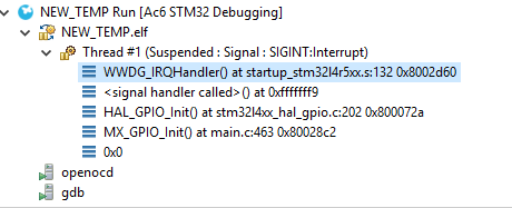

2018-06-01 1:21 AM
Thanks for the support.
I have taken the systemconfig from the sample code provided from L4 Software Stack bundle.
But now when i apply this code what you have provided.
Now its clear that the stack before entering the RESET / WDT.
It looks like this
From GPIO its picking.
May i post some more info after debugging.
Thanks
Phani
