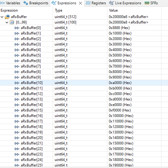

The issue is: I'm using STM32L4R5VIT6 (as OCTOSPI master in Hyperbus mode) to test our OCTSPI slave, In this when we try to read data (or slave register read) from slave, noticed that the first read data value is always (0x8888) and next values are shifted by 16 bits. Please lets us know your suggestions on this behavior.

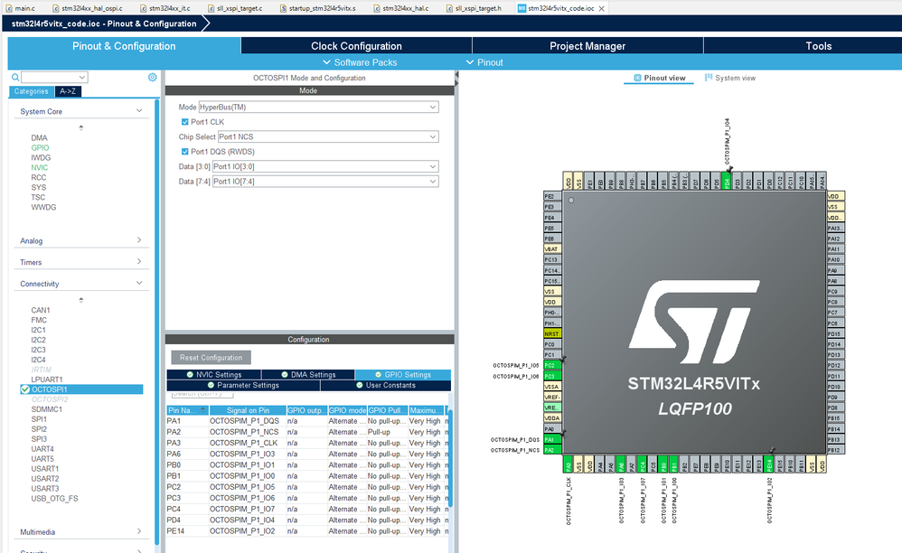

Note: attached STM32L4R5VIT6 configurations and read buffers values at STM32 side. Using STM32CubeIDE-Win 1.12.1 to generate the code and run.
Please review the STM32L4R5VIT6 settings and let us know if any modifications are needed.

We are connecting STM32 clock, reset, Chip select, RWS and data 8:0 pins to slave respective pins via FMC
There is RX and TX memory space of the slave, we are writing to RX memory space and reading from TX memory space.
The read problem is not only for memory write and read, even for simple slave register read also we are seeing 0x8888 on any register read.
