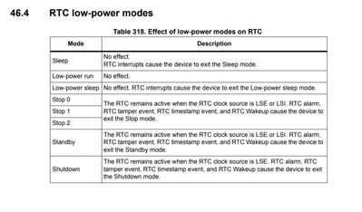

can we wakeup from stop mode from RTC internal alarm
2024-01-20 6:08 AM
According to the RM0432, the RTC alarm,RTC tamper event, RTC timestamp event, and RTC Wakeup cause the device to exit the Stop mode.
