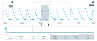

Power Measurement Graph
You can clearly see periodic current spikes corresponding to the LCD refresh intervals. The average current remains around 5–6 µA, but these periodic spikes are preventing us from reducing the base consumption further.

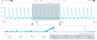

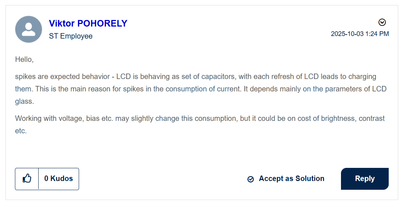

2025-10-03 5:24 AM
spikes are expected behavior - LCD is behaving as set of capacitors, with each refresh of LCD leads to charging them. This is the main reason for spikes in the consumption of current. It depends mainly on the parameters of LCD glass.
Working with voltage, bias etc. may slightly change this consumption, but it could be on cost of brightness, contrast etc.
