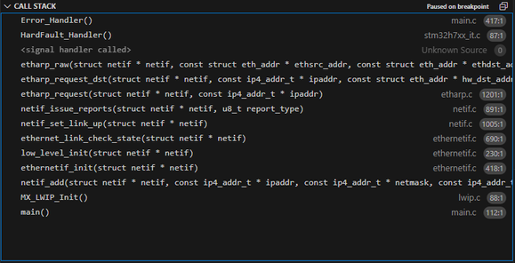

I'm quite new to STM32, and I'm trying to get LwIP up and running on my NUCLEO-H723ZG. No matter what I've tried so far, my board has always goes into HardFault, specifically during MX_LWIP_Init(), when the HAL calls etharp_raw(). Here is the full call stack for reference:

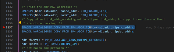

Here are the lines of code in etharp.c in which the HardFault occurs:
etharp_request_dst():
etharp_raw():

Dump out the register set from the fault, and the instructions there.
My guess would be that ipsrc_addr is an accessible memory address, at all, or misaligned.
Start by looking at what it is the processor doesn't like, not shot-gunning a whole bunch of code, heap or stack changes.
Once you know specifically what the processor is objecting too, work backward from there, perhaps adding telemetry output or sanity checks.
