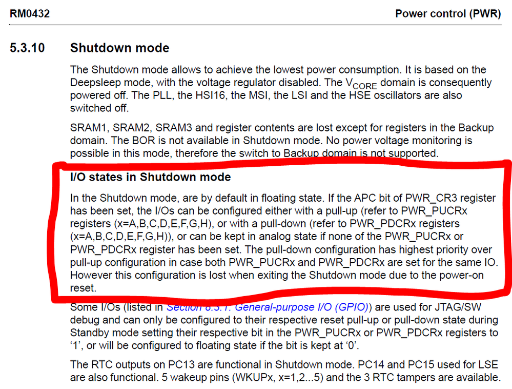

For STM32L4R5QII6 is there any way that we can control GPIO i.e., PF15 pin when the MCU is in Shutdown state. Do we need to have any pull-up for those GPIOs which need to be controlled?

From the reference manual:
2020-09-16 6:40 AM
