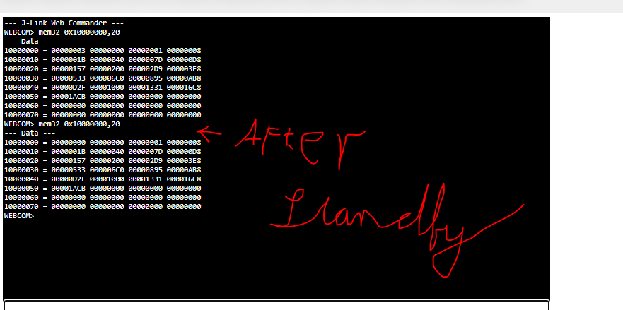

Now data can be initialized within SRAM2 like this:
volatile uint32_t Counter __attribute__((section(".ram2")));
volatile uint32_t test123[20] __attribute__((section(".ram2")));Et voilà:
I saved n³ (for n from 0 to 19) in test123, and counter was reset on purpose.
