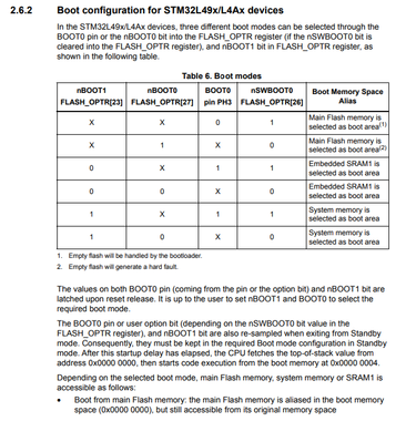

But in the errata sheet and if I understand well, booting with pin PH3 doesn't work:
Dual-bank boot not working when the boot in flash memory is selected by BOOT0 pin
Description
When the nSWBoot0 option bit is set and the BOOT0 pin level is low, the dual.bank boot does not work (BFB2
option bit = 1).
The user code is only executed when BANK 0 is valid.
Workaround

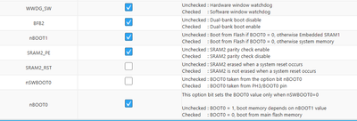

Do not rely on the BOOT0 pin to select the boot in flash memory. Instead, use the option bytes for that purpose,
setting the nSWBoot0 option bit to 0, the nBOOT0 option bit to 1, and the BFB2 option bit to 1. This setting allows
the correct check of the address 0 of the two memory banks, in order to execute from the correct one.
