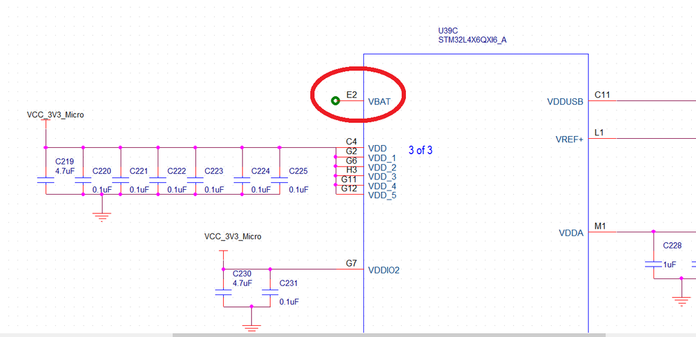

Can the VBAT pin on this part be left floating? I currently have the pin disconnected. Or should it be tied to VDD or GND in order for the part to function properly?
Thanks,
2024-04-09 12:21 PM - edited 2024-04-09 12:26 PM
Vbat pin must be connected to VDD even if VBAT block (RTC.. etc ) is not used.
