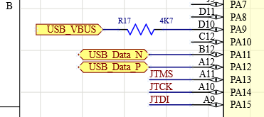

2021-06-16 5:39 PM
Alberto,
Did you have a chance to throw in the logic analyzer to capture the signal of the USB detection pin at the power up? Chance there are periods of times the signal was not stable because the STM32 going thru the reset and GPIOs going thru the initialization? I learned the hard way before when I took think for granted and think the signal is on the level that I think it is, but as soon as I got the capture, my signal went up and down and vice versa for so many time especially when I utilize the reset pin input to STM32 mcu.
2021-06-16 7:52 PM
No, we didn't. The USB port (the host PC) provides our board with 5V over a 4.7K resistor in series into pin PA9 (I believe). The power to the board is generated independently. PA9 is read in the background at a frequency of 50 Hz or so, and that starts or stops the USB peripheral accordingly.Cheers,
Alberto

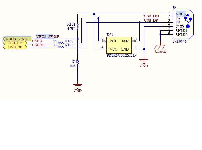

2021-06-17 12:02 AM
I believe if you have the pull low in the USB_VBUS it will help to prevent those glitches, in my case VBUS_SENSE is the same as your USB_ VBUS
