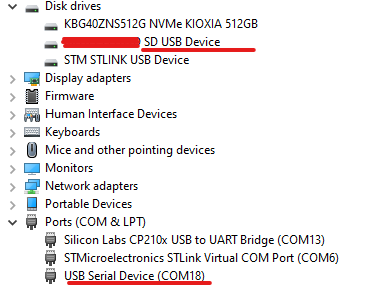

That would be an alternative, but a slow one. USB allows you to have dual functions, that is, VCOM on one endpoint and MSC on the other. In my case I have a VCOM on COM18 AND a USB drive (see image below).
On the USB MSC side, you have to implement USB read file and write file operations using the Read / Write block functions in usbd_storage_if.c (well... I use them for convenience):
