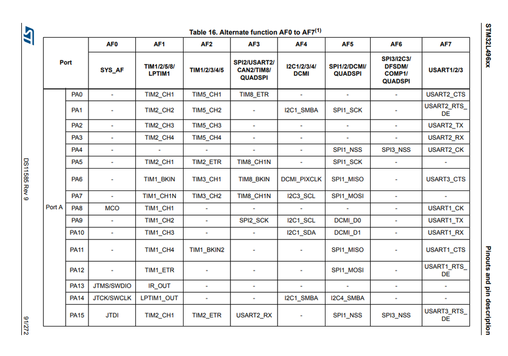

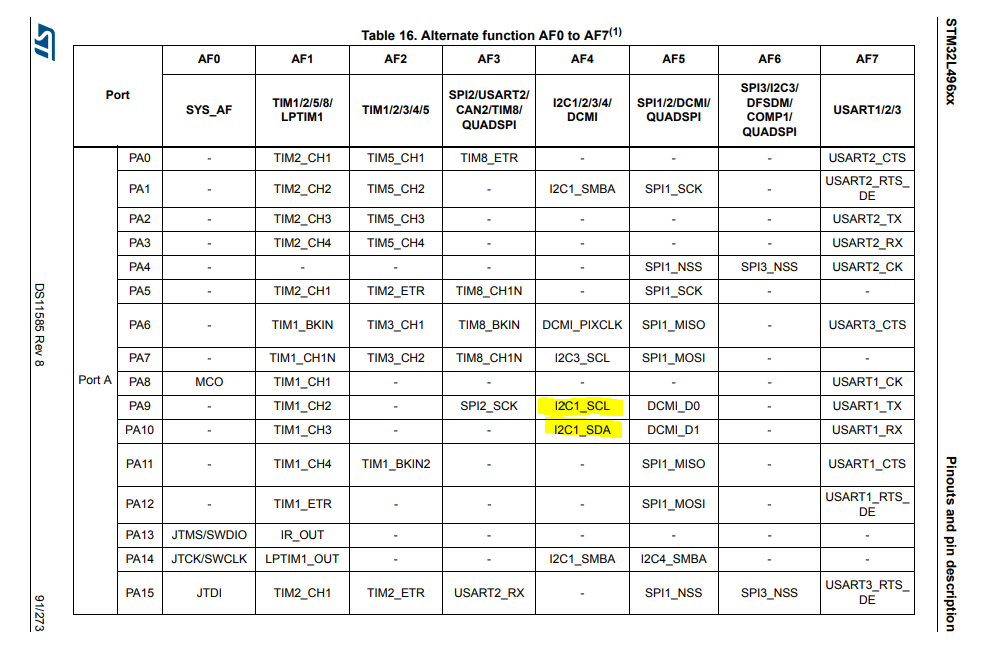

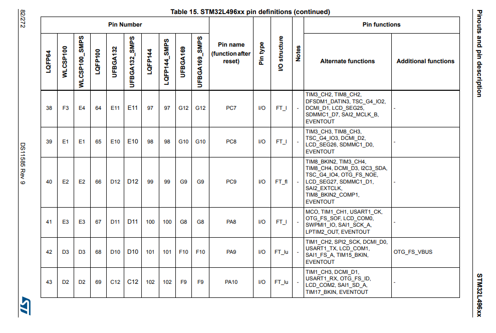

2018-07-27 5:33 AM
Looking at the datasheet further I have noticed that it does not show pins PA9 and PA10 as supporting I2C as an alternate function in table 15.
Can ST confirm that this is the case, as in table 16 it shows that PA9 and PA10 are connected to I2C1.
2018-08-03 3:47 AM
@Imen DAHMEN Can you comment on this?
