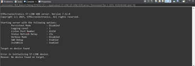

CubeProgrammer now shows:
Error: Unable to get core ID
Error: ST-LINK error (DEV_TARGET_CMD_ERR)
No STM32 target found

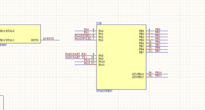

SWDIO, SWCLK, RST, VDD, GND routed through through-hole pads

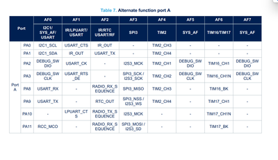

I saw advice suggesting to force the chip into the UART bootloader by pulling PA10 HIGH and resetting.
However, since I designed a custom PCB (not the NUCLEO-WB05KZ), I manually tie PA10 to VDD and then reset, but SWD still does not reconnect.
I have attached the PCB pinout and SWD/UART wiring for reference (in the actual forum post).
How can I recover the STM32WB05KZ and re-enable SWD?

See AN2606 for ways to boot up into the bootloader. Once in the bootloader, SWD will work.
If none of those are feasible, you will need to try to hit "Connect" on STM32CubeProgrammer right after power is applied and before the firmware goes into low power mode. Depending on your program, this may or may not be possible.
Those are the only options.

2025-12-07 8:52 PM
Hi TDK
Thank you so much.It's working.
