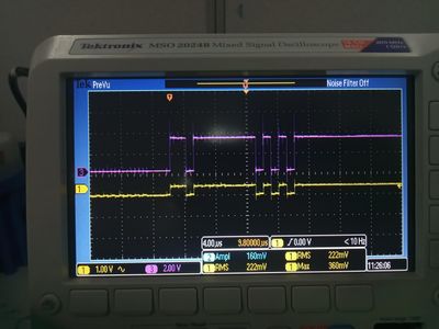

The debug terminal :
Please find the attached Oscilloscope images:
Blue : MOSI
Yellow : Clk
Pink : MISO

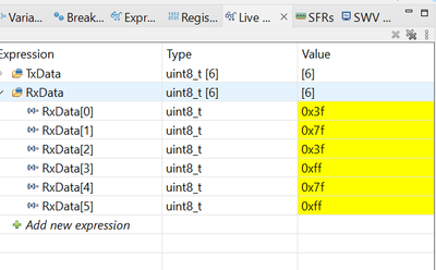

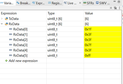

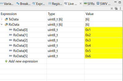

2025-01-10 1:42 AM
Thank you for your reply.
I attempted to interface the AFE (ADBMS6830) with the STM32L476RG Nucleo board. Currently, I am receiving the transmitted data along with additional values. I need to verify if the received data is accurate.
I am attaching the debug terminal screenshots. Please provide technical insights.

2025-01-19 11:20 PM
Thankyou for your reply.
I used an oscilloscope to measure the signals, and I observed that the MISO signal mirrors the MOSI signal. However, the voltage level of the MISO signal is significantly lower. Additionally, the debug terminal consistently outputs 0xFF.
Could you provide some insights into why this might be happening?
2025-01-20 1:13 AM
That doesn't look right. If I read your scope properyl that's only about 0.5 volt on the MISO channel.
How are your devices connected? Are they on the same PCB? If not, make sure you have a common GND connection between the two, as well as the MISO, MOSI, SCK and CS lines.

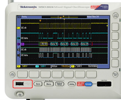

2025-01-20 3:59 AM - edited 2025-01-20 4:02 AM
Your scope has a USB socket for capturing screenshots:
This will give you far better results than trying to take photos of the screen!
Are you sure your probes and/or scope channels are correctly configured - for x1, x10, etc?
