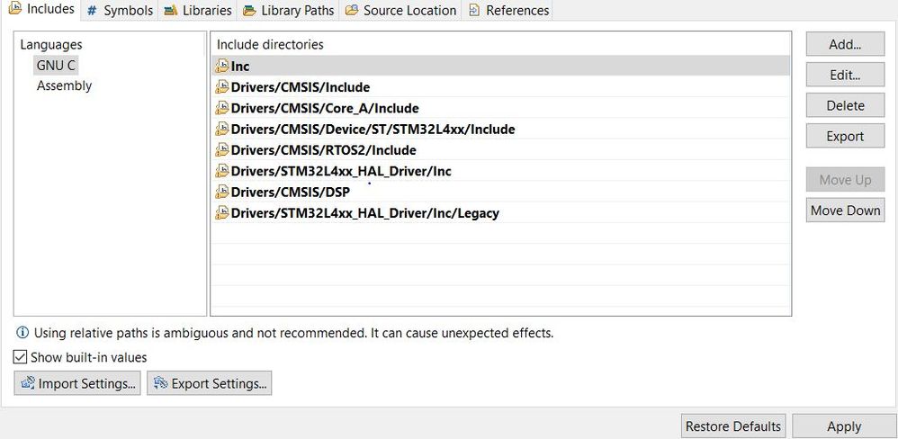

I saw similar issues on SO and on this forum and I did my best to search and include files in the path of the project, as indicated in the picture:

RTE_Components.h would be from KEIL, and related to their licensed middleware typically
The math include is in the DSP include directory, you'd need to add that to your list
STM32Cube_FW_L4_V1.15.1\Drivers\CMSIS\DSP\Include\arm_math.h
Drivers/CMSIS/DSP/Include

I see, I was able to find the DSP/arm_math.h library, but I'm not sure why it complained to me and wasn't included in my project from the get-go.
