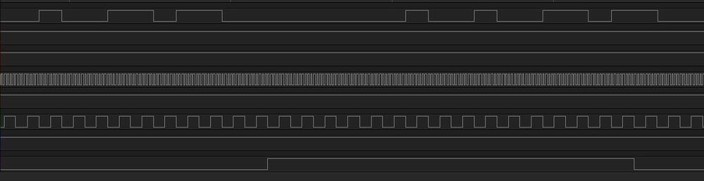

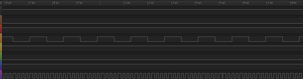

I attached 2 files.
In non working example with SAI2 you can see only MCLK and SCK.
Another signals seems to be no (logic one everwhere).
But in another picture with standard example everything is ok
2016-07-19 11:24 PM
Logic one - for I2C and reset - this is normal
But other important lines are zero!2016-07-21 12:51 AM
Sorry. In the first message I gave an incorrect info about block B of SAI1. It is not working too with the same thing described in picture! You can see only near 700KHz bit clock signal and 6 Mhz input clock signal for codec. Codec init was succes on I2C but then the same situation is here too.
2016-07-21 12:58 AM
For B block tests I redefine the definitions in example to SAI:
#define AUDIO_SAIx SAI1_Block_B#define AUDIO_SAIx_CLK_ENABLE() __HAL_RCC_SAI1_CLK_ENABLE()#define AUDIO_SAIx_FS_GPIO_PORT GPIOB#define AUDIO_SAIx_FS_AF GPIO_AF13_SAI1#define AUDIO_SAIx_FS_PIN GPIO_PIN_6#define AUDIO_SAIx_SCK_GPIO_PORT GPIOB#define AUDIO_SAIx_SCK_AF GPIO_AF13_SAI1#define AUDIO_SAIx_SCK_PIN GPIO_PIN_3#define AUDIO_SAIx_SD_GPIO_PORT GPIOB#define AUDIO_SAIx_SD_AF GPIO_AF13_SAI1#define AUDIO_SAIx_SD_PIN GPIO_PIN_5#define AUDIO_SAIx_MCLK_GPIO_PORT GPIOB#define AUDIO_SAIx_MCLK_AF GPIO_AF13_SAI1#define AUDIO_SAIx_MCLK_PIN GPIO_PIN_4 #define AUDIO_SAIx_MCLK_ENABLE() __HAL_RCC_GPIOB_CLK_ENABLE()#define AUDIO_SAIx_SCK_ENABLE() __HAL_RCC_GPIOB_CLK_ENABLE()#define AUDIO_SAIx_FS_ENABLE() __HAL_RCC_GPIOB_CLK_ENABLE()#define AUDIO_SAIx_SD_ENABLE() __HAL_RCC_GPIOB_CLK_ENABLE()2016-07-21 1:12 AM

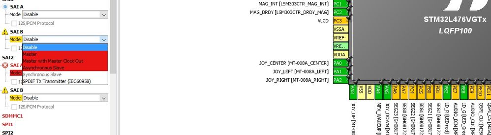

I also cann't understand why I cann't choose the block B in cubeMX software to choose the master mode with clock output?
