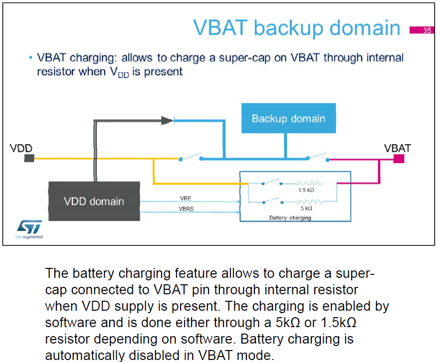

Thank you for answer. Well, can I connect directly the capacitor to the Vbat pin of Mcu as following image and call the function in order to enable battery charging module?
In the datasheet of it says that there is a internal resistor and inverse diode to vdd. So, I understand that it can charge itself without any materials.
2018-01-14 5:06 AM
Yes, you can do it. Below I attach a slide, which refers to such scenario:
Regards
Szymon
