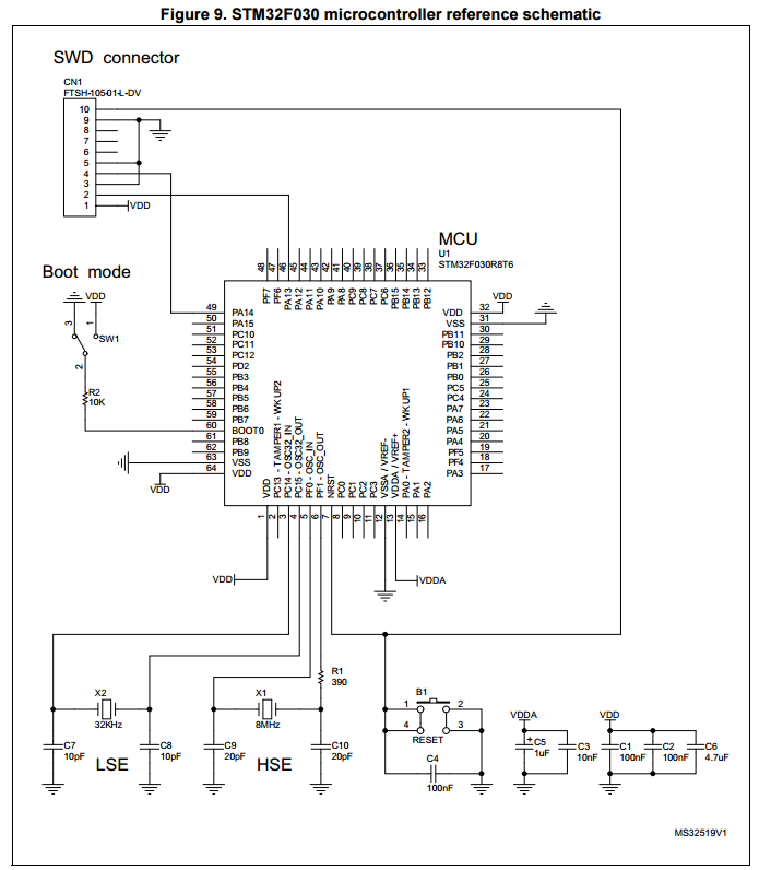

Hello Jesus Perez,
I made a review of your schematics. Let me share with you its outcome:
Supply pins
Reset pin
BOOT pin
Capacitors
For more information please refer to
http://www.st.com/resource/en/application_note/dm00089834.pdf
. Below I attach a picture with reference schematics.Regards
