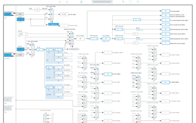

I have the following clock tree for STM32L471
I am using TIM2 as trigger for DAC, ADC1, and ADC2 at 2.4MHz. Clock frequency of TIM2 is 48MHz with a counter value of 19 and prescaler = 0.
With oscilloscope, I confirmed that the DAC is generating the signal at 2.4MHz sampling frequency.
The ADC1 and ADC2 are running in dual mode with single DMA channel. The following is the ADC configuration
