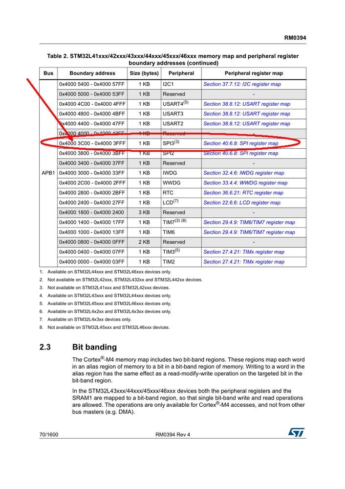

2021-12-09 2:04 PM
> CPAR1 0X4001 3C03
And the DR is at offset 0x0C, i.e. SPI->DR is at 0x40003C0C.
2021-12-10 11:58 AM
Yes I copied the register value incorrectly. Twice. In my code I had 0x40013c3c then I copied it to my list as 0x40013c03 and the correct value is 0x40003c0c.
I will test with that. Incorrect data register address should stop things from working. Thanks.
2022-01-13 9:01 AM
I ran the tests with corrected values and had more success. The DMA_Transmit started correctly. However the DMA Receiver was never started. The SPR Status register showed receive FIFO overrun. I could not find any SPI DMA Receive Interrupts that were activated when the transmit was in process or completed. Reviewing the details again.
