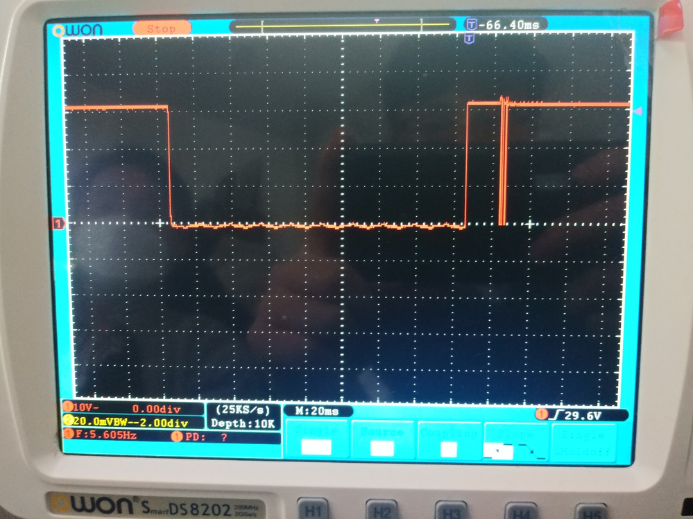

I implement the SD Card access using the SDMMC1 on the NUCLEO-H743ZI board + SD Card sub board.
Now the SDMMC1 Interrupt was not occurred after the DMA request setting and SDMMC interrupt enable(DCRC, TIMEOUT, RXOVERR, DATAEND) for reading the MBR block of the SD Card.
The SDMMC global interrupt is enabled initially.
I have checked the SDMMC Data signal.
I found the valid data signal at the initialization time for the SDMMC operation.
But there is not any data signal after DMA request and SDMMC interrupt enable setting.

}I think that the SDMMC interrupt should be occurred if though any data is not received.
(Because the time out interrupt is enabled.)
Question 1)
If the initialization process of the SD card is passed, the SDMMC Interface is ok.
isn't it?
Question 2)
After the DMA configuration for reading the MBR block in the SD Card, there
isn't any data on the signal line. What should I check for resolving this problem?
Question 3)
If though any data is not received after the DMA configuration, the SDMMC
interrupt must be occurred because of the time out, isn't it?
I attach the data signal from the initialization to the DMA Read configuration.
Thank for your concerning.
