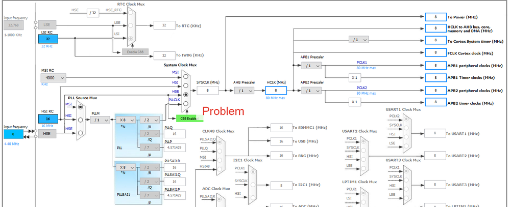

Hello, Help me please. I configuration STM32L452RET6 in the CUBEMX, how on the pictures. Then I build project in the Attolic and go to debuger and then when MCU is starting work, it go in the HardFault_Handler(void) through 1-5 seconds. Why? I can't find problem. Maybe anyone know?
Crystal clock is Abracon LLC ABM9- 8.000MHZ-10-D-1U-T.

#stm32l452 #stm32l4 #no-working-hse-stm32l42018-07-10 2:55 AM

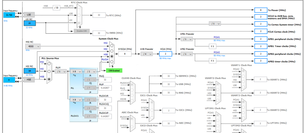

Sorry, If I am reducing core clock, the problem save

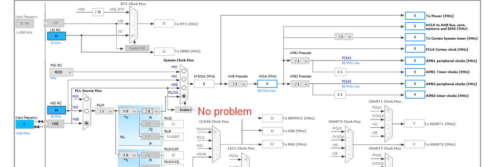

If I connect System Clock Mux to PLLCLK, no problem. But if connecting to HSE, problem is save.
