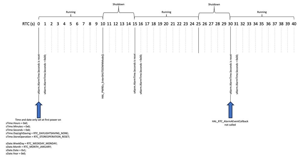

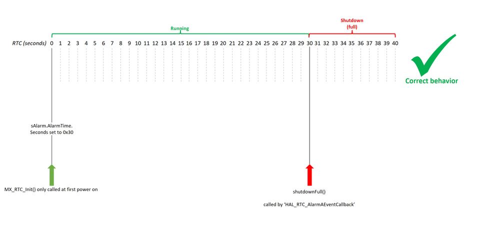

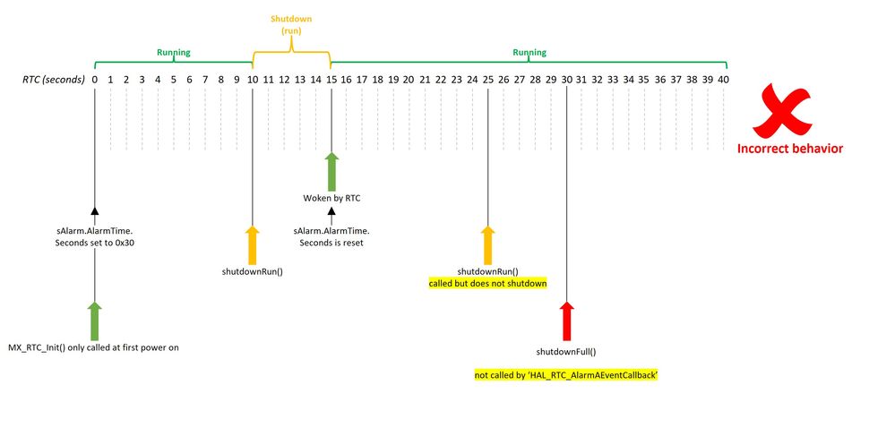

2025-07-27 1:25 PM - edited 2025-07-27 1:27 PM
Is the problem caused because sAlarm.AlarmTime.Seconds is reset when shutdown ?
For test purposes, I am using the following settings:
The MCU runs for 10 seconds, then shuts down for 5 seconds using the functions:
When the MCU wakes, sAlarm.AlarmTime.Seconds is zero, so I have to set it back to 0x30 (should it be 0x30 or decimal 30, I'm not sure because its BCD ?).
The diagram below explains what I think might be happening, it should fully shut down and not wake again when the alarm is reached (30 seconds). But maybe it doesn't because sAlarm.AlarmTime.Seconds is reset when shutdown. ?
The application is battery powered and once manually switched on, it is supposed to read a pressure sensor every few minutes then shutdown between each measurement.
After 12 hours of being switched on, it is supposed to permanently shutdown and not wake again until switched manually on again.
I am using shorter times for test purposed, the 5 second shutdown and wake for 10 seconds works.
But the permanent shutdown (set by sAlarm.AlarmTime) is not working.
I have either implemted this wrong or it is not possible ?
2025-07-27 2:16 PM
I suspect it's because, on startup, you're initializing RTC regardless of its current state. You should check to see if it's already initialized and, if so, don't touch it.
Implement code in the first user block within MX_RTC_Init that checks to see if it's initialized already.
2025-07-28 4:00 AM - edited 2025-07-28 5:09 AM
I only initialize the RTC once, because I check if the MCU was woken by the RTC as follows...
if (__HAL_PWR_GET_FLAG(PWR_FLAG_SB)) {
// Woke from standby
__HAL_PWR_CLEAR_FLAG(PWR_FLAG_SB);
else
MX_RTC_Init();
I set a breakpoint on the line MX_RTC_Init() and the breakpoint is only hit on the first startup. When the RTC wakes the MCU, the breakpoint is not hit.
The diagram below shows the behavior I expect...
The diagram below shows what is actually happening, with the following observations made...
The diagram below shows the alarm works if I don't shutdown with RTC wake...
Below is the main code...

Hey there! Can you send your HAL_RTC_MspInit ? Just want to check you have NVIC lines properly enabled. Just to calm you down, the setup you intend is perfectly doable irl, i have multiple projects where i used that rtc management.
Also beforehand for acquiring good practises i recommend you always clear flags before setting interrupts, example:
HAL_NVIC_DisableIRQ(RTC_WKUP_IRQn);
HAL_RTCEx_DeactivateWakeUpTimer(&hrtc);
__HAL_RTC_WAKEUPTIMER_CLEAR_FLAG(hrtc, RTC_FLAG_WUTF);
NVIC_ClearPendingIRQ(RTC_WKUP_IRQn);
HAL_NVIC_EnableIRQ(RTC_WKUP_IRQn);
HAL_RTCEx_SetWakeUpTimer_IT(&hrtc, 599, RTC_WAKEUPCLOCK_CK_SPRE_16BITS, 0);
Although from your graphic i guess the first wakeup from wakuptimer is happening, isn't it? Make sure the wakup flag is getting cleared properly, usually generated automatically in stm32xx_it.c file. Can you sum up the current issue in 3 lines max clearly please?
