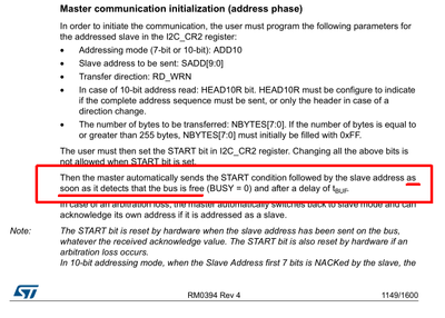

When I2C master transaction (both Rx and Tx) is started while SCL is pulled to 0 externally, it goes into BUSY mode (I2C_ISR=0x8001) and remains there indefinitely, without setting any interrupt-generating flag, even after the external SCL->0 is removed.
This is extremely simple to reproduce, well, just short SCL to ground and write any START-containing "command" to I2C_CR2; and then remove the short, while observing I2C_ISR. It's enough to do it in debugger with stopped processor, the result is obvious enough.
I expected, that either
1. I2C throws a BERR (I would prefer this, but BERR's description says its scope is limited to a very particular bus error involving only STOP and START - and the BERR-related erratum dismisses its real-world usability entirely), or,
2. upon removal of SCL->0 I2C proceeds with the transaction as normally.
Documentation says, it's 2.:
This issue - which I consider to be a flaw - makes implementation of a sturdy I2C master based entirely on I2C interrupts impossible; there must be an additional timeout implemented. Together with TXIS-when-NACK issue, it makes proper I2C software significantly more complex than if the I2C would be correctly implemented according to documentation.

Also, please note, that the observed behaviour contradicts the documentation, as I've highlighted above.
Can you please address these concerns.
