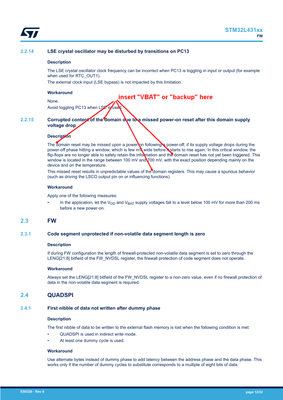

Hello @waclawek.jan
Thank you for reporting this. I will check it internally and get back to you as soon as possible.
Best Regards.
STTwo-32
2023-11-29 2:38 AM
Thanks again for bringing this issue to our attention.
I confirm the issue and I reported internally.
Internal ticket number: 167452.
PS: 167452 is an internal tracking number and is not accessible or usable by customers.
