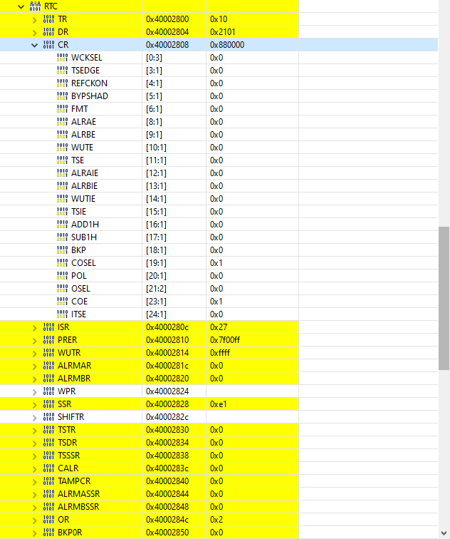

And what's in the RTC registers now?
2020-07-03 6:32 AM
Same as in case 2

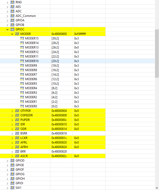

So, you set RTC registers as in case 2, and input signal is OK? And then when you change PC13 GPIO_MODER from the default Analog to In, the input signal suddenly changed amplitude, correct?
2020-07-03 9:52 AM
Yes i set the RTC registers as in case 2.
The input signal is always a 1 Hz clock with amplitude 3.3 V.
The amplitude changes when COE bit set. If this bit isn't set, then the PC13 works as expected as normal gpio exti or as RTC_TS (see case 1). Always when the COE bit is set, the amplitude of PC13 is 1.4 V.
I guess, when the RTC COE bit is set, the PC13 gpio registers are ignored.
2020-07-05 5:04 AM
OK, so the bug is, that if RTC_CR.COE=1 and RTC_OR.RTC_OUT_RMP=1, PC13 is *not* controlled by GPIO as it should, and is turned to output.
