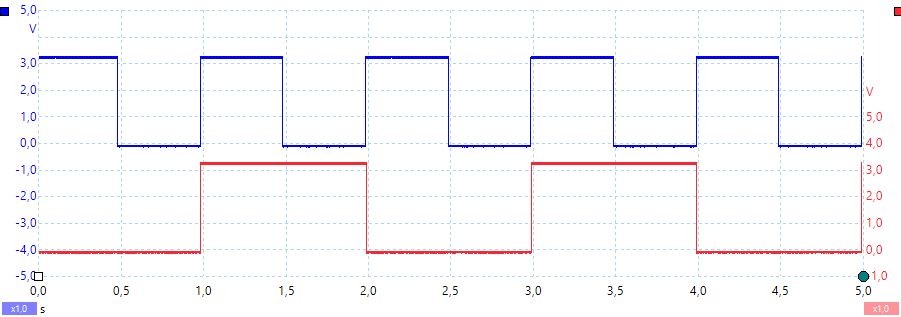

Is only only the TimeStamp function configured, then it works also as expected. Blue is a clock with e.g. 1 Hz and the red signal is a gpio which will be toggled by the TimeStamp callback function. It works also as expected.

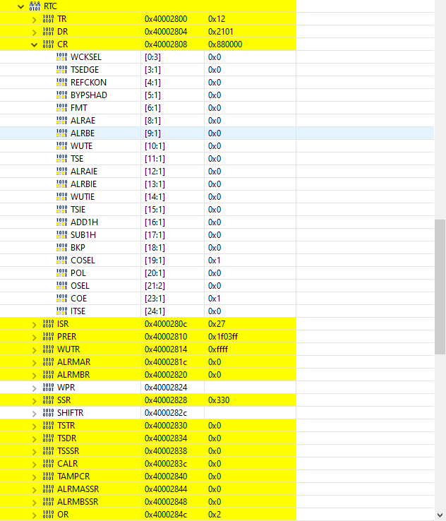

OK so if you read out the RTC registers, what exactly do you see in those bits, in all three cases?
2020-06-27 3:40 AM
I guess i see what i expect.
Case 1
Case 2
Case 3

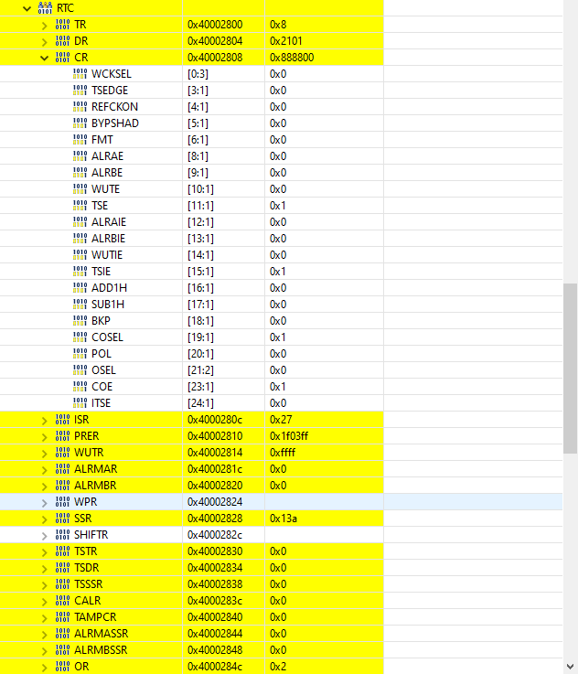

2020-06-27 4:49 AM
Indeed looks logical.
Pity you did not show us the registers when the external 1Hz signal is connected to PC13/RTC_TS - according to your description, at least in case 2 that should have effect on the registers.
I wonder, whether in case 3 that does or does not have similar effect on the registers.
[case 3]
> The signal at the TS input has only a voltage of 1.4 volts.
I don't understand. Isn't that your external 1Hz signal? How is it different from case 2?

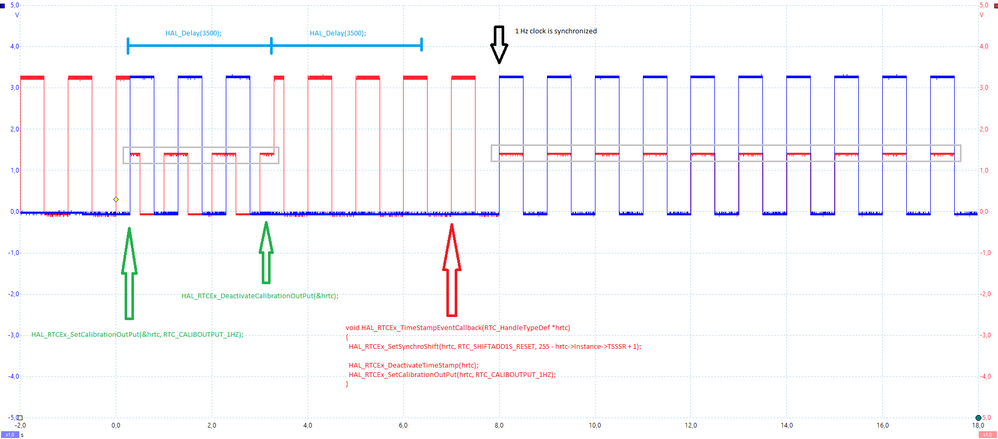

2020-07-02 10:26 AM
I wanted to use the RTC_TS for time synchronization because a rising edge triggers an interrupt and at the same time the current time is transferred to the TS register.
With the timestamp I would know how many sub-seconds the RTC of the L4 deviates and could correct this with the shift function.
void HAL_RTCEx_TimeStampEventCallback(RTC_HandleTypeDef *hrtc)
HAL_RTCEx_SetSynchroShift(hrtc, RTC_SHIFTADD1S_RESET, 255 - hrtc->Instance->TSSSR + 1);
HAL_RTCEx_DeactivateTimeStamp(hrtc);
HAL_RTCEx_SetCalibrationOutPut(hrtc, RTC_CALIBOUTPUT_1HZ);
}Example
HAL_RTCEx_SetCalibrationOutPut(&hrtc, RTC_CALIBOUTPUT_1HZ);
HAL_Delay(3500);
HAL_RTCEx_DeactivateCalibrationOutPut(&hrtc);
HAL_Delay(3500);
HAL_RTCEx_SetTimeStamp_IT(&hrtc, RTC_TIMESTAMPEDGE_RISING, RTC_TIMESTAMPPIN_DEFAULT);The blue signal is the calibration output and the red signal is the 1 Hz clock with the RTC is to be synchronized.
So that I get an RTC_TS interrupt, I always have to switch off the caliboutput. If the COE bit is set, as you said, the RTC_TS may be configured as an output.
