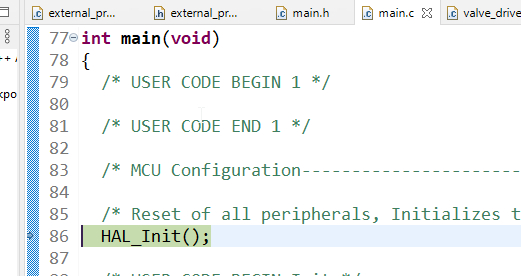

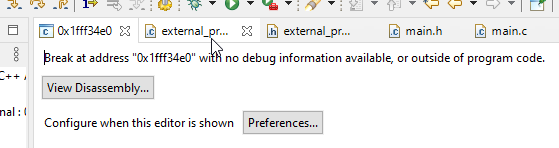

I have a problem when debugging STM32L4 form CubeIDE with STLINKV2, the debugger only starts every other time. First start of debug session is ok, program halts at "main()". When debug session is closed and started again, the download is successful, but the CPU does not halt at "main()". If I press "pause", it is stuck in ROM code at 0x1fff523e. Seems to be bootloader code. I can see a bootloader device on my PC via USB.

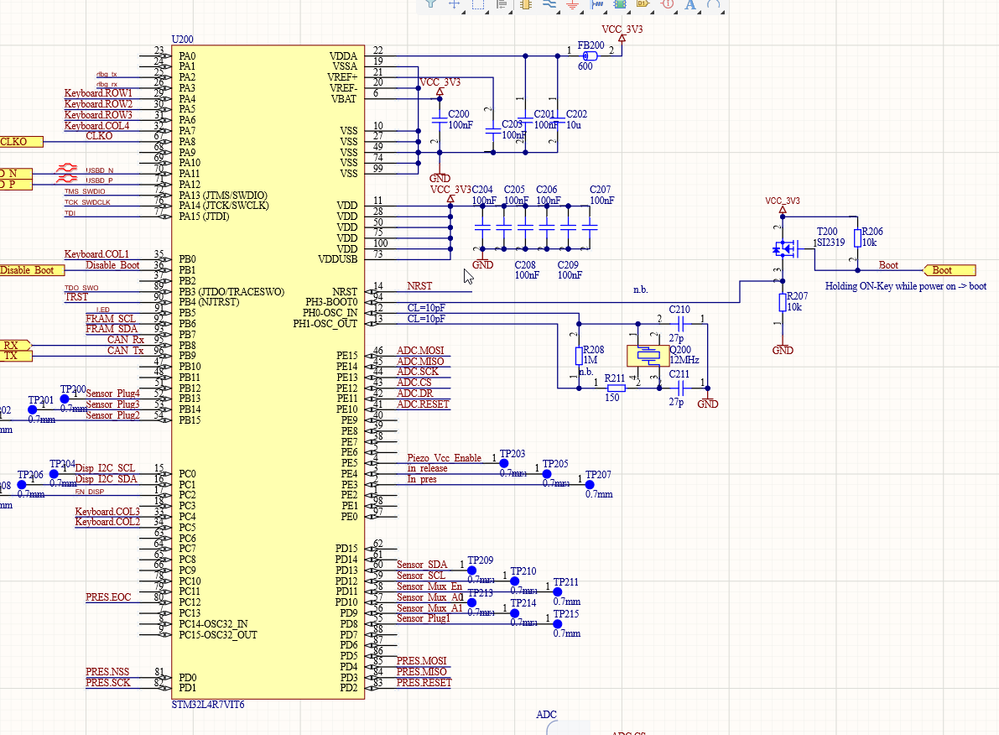

Why does the CPU enter bootloader code here? The boot pin is fixed to LOW. I have checked with oscilloscope during start time. The Boot-Pin is not used for anything else and is not assigned to GPIO or something.
When stuck in bootloader code and the debug session is restarted once again, the program now runs fine and stops at "main()". Next try -> again stuck in bootloader code....

Custom board? Is BOOT0 tied low?
Does your firmware jump to the bootloader anywhere?
2021-06-14 7:35 AM
Custom Board.
boot0 is tied low and checked with oscilloscope during reset
firmware does not jump to bootloader
T200 is not open during boot.

I observe a third stage. The debugger manages to run to void(main) but then gets lost in "HAL_Init"
I am using free RTOS and have assigned Timer 7 to create the system tic.
"HAL_init" gets lost immediately in "HAL_initTick" , HAL_TIM_Base_Start_IT(&htim7) , HAL_TIM_ENABLE(htim) -> jumps into bootloader

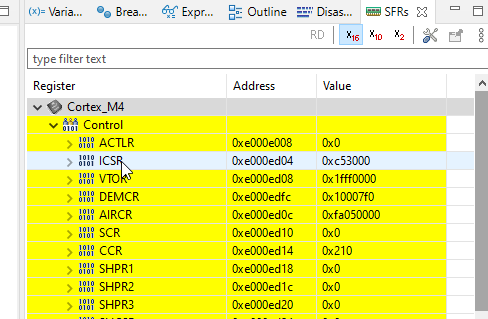

Next observation: In case of a "not running" debugger, the vector table does not point to 0. It points into bootloader code
see register "vtor"
in this example to 0x1FFF0000
