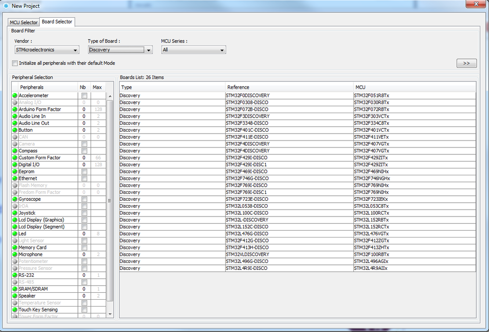

Hello
greenwood.greg
,The discovery boards are available in the current CubeMX release (4.23).
Here are the lists of discovery boards available in CubeMX :
BR. Jeanne
