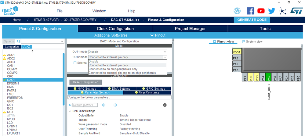

I noticed the Timer trigger option and I want to use this.

I recommend you to choose a Timer, generate pwm or output compare periodic signal on a timer output channel. with a jumper wire, connect it to the DAC trigger pin. Once things looks working well, use internal signals to avoid using 2 GPIOs.
Each timer rise edge for example will trigger a dac update. Typically, you can have a waveform put in Flash or RAM and use a DMA to sweep through all the DAC values to update sequentially and periodically. This is a simple way to make a sinewave. If the Timer generates 1 MHz PWM and the table is made of 1000 samples, the DAC waveform will be 1 kHz period.
