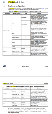

The Bootloader is not available throw the STM32L152RET6. It is only available on the USART1 and USART2 only according to the AN2606:
For the Usartx Line, it refers to x=1 or 2. Systick timer should be enables to automatically detect the serial baud
rate from the host for USART1/2 bootloader

... and the line USARTx refers to the previous lines with the supported interfaces, i.e. USART1/2.
