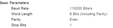

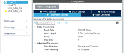

I'm working on a communication setup between two STM32 boards: a master board (STM32F446RE) and a slave board (STM32F401RE). The goal is for the master to send the bootloader command 0x7F to the slave, and then capture the acknowledgment (ACK) sent back by the slave. This acknowledgment will be displayed on the Hercules Serial Monitor for debugging and verification.
UART Connections:
Master Board Debugging:
Reset Mechanism:
The command I’m trying to send to the slave is 0x7F, which is typically used in bootloader communication to trigger a response from the slave. I’m expecting the slave to send an acknowledgment (ACK) back to the master once it receives this command. I have also make sure that my slave is in the bootloader mode by setting the BOOT0 pin to high as you can see in the connections snapshot.

}Despite setting everything up correctly, I'm not receiving the acknowledgment (ACK) from the slave board after sending the bootloader command 0x7F. I’ve added debug messages in the code to track the progress and help pinpoint where the issue may lie, but the ACK still isn't showing up in the Hercules Serial Monitor.
The output from the serial monitor isn't showing the expected response, and I suspect the issue may be with the communication between the boards or how the slave is handling the bootloader command. Could you please help me figure out what might be going wrong?

2025-03-07 7:51 PM
8 bits + even parity = 9 bits (including parity) word length. You have 8 bits set.
