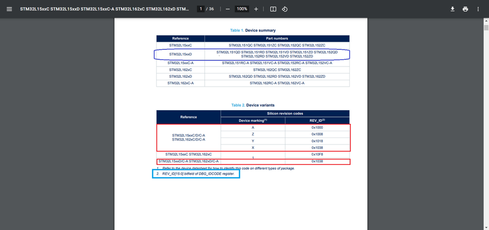

What I have noticed that for the particular MCU there is A, Z, Y, X, 1 revision (according to errata sheet) and no one has 10f8 ID CODE.
Looks like i got a clone.

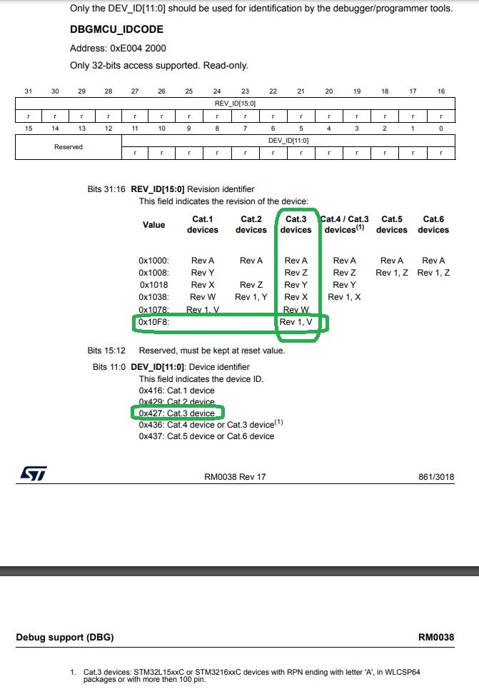

The Reference Manual and the Errata?
The RM should have details of the Chip, Stepping/Revision, and also the address in OTP to read the tested flash size from.
STM32L15xxC STM32L162xC Rev 0x10F8

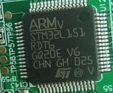

Should be marked as "1" or "V", please attach a large, clear, in focus image of the part in question.

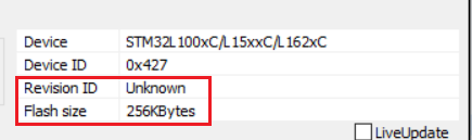

Cube Programmer also can not recognize the REV ID:
19:16:00 : Board : --
19:16:00 : Voltage : 3.25V
19:16:00 : SWD freq : 4000 KHz
19:16:00 : Connect mode: Normal
19:16:00 : Reset mode : Software reset
19:16:01 : Device ID : 0x427
19:16:01 : Revision ID : --
19:16:01 : UPLOADING OPTION BYTES DATA ...
19:16:01 : Bank : 0x00
19:16:01 : Address : 0x40023c1c
19:16:01 : Size : 136 Bytes
19:16:01 : Bank : 0x01
19:16:01 : Address : 0x1ff80000
19:16:01 : UPLOADING ...
19:16:01 : Size : 1024 Bytes
19:16:01 : Address : 0x8000000

And the screenshot of document is page of ERRATA to L15xx family of devices
