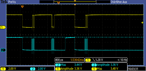

I want to use a STM32L151RDT6 as I2C slave and a USB to I2C bridge from FTDI as master.
Reading command with the slave from the master is possible. But when i try to transmit data to the master the slave is releasing the SDA Line after the acknowledge. But the master expected a low SDA line bevor he start clocking for the databyte.
I had oriented on the example code: STM32Cube/Repository/STM32Cube_FW_L1_V1.9.0/Projects/NUCLEO-L152RE/Examples/I2C/I2C_TwoBoards_RestartComIt
