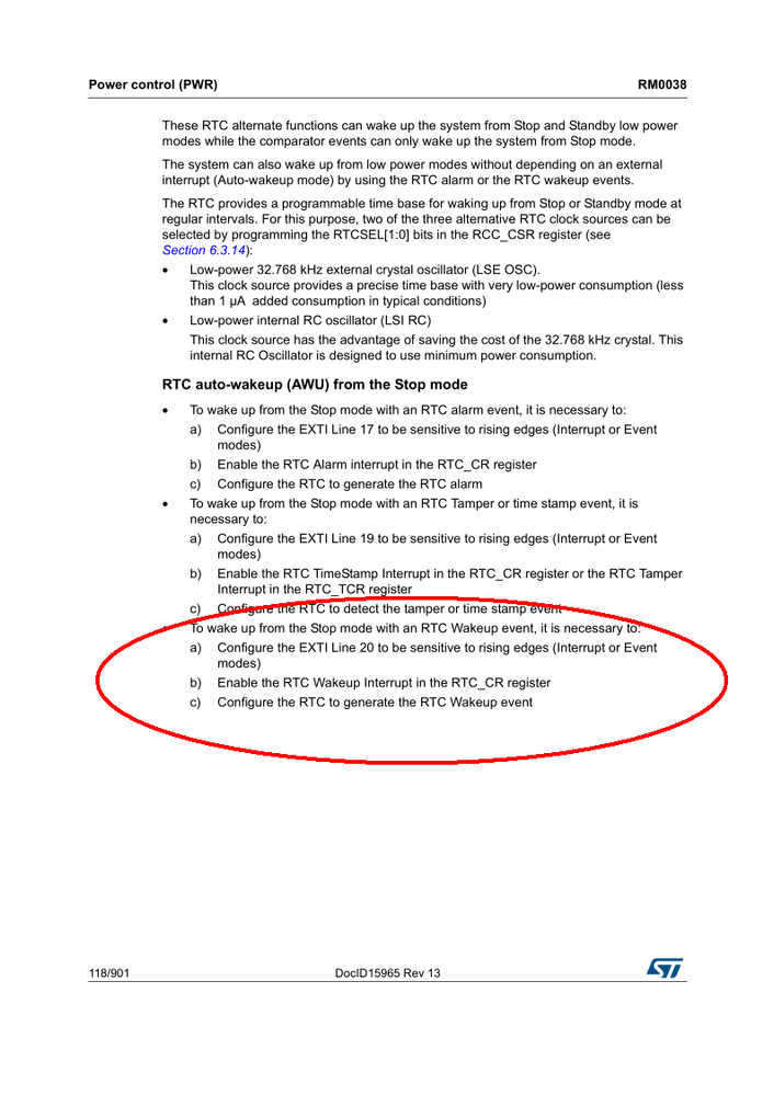

For wakeup, make sure you follow all these steps:
i.e. read out and check all relevant RTC and EXTI registers content.

RTC wake-up EXTI line 20 is Enabled.
RTC CR->WUTIE setted
RTC CR->WUTE setted
But not works...
