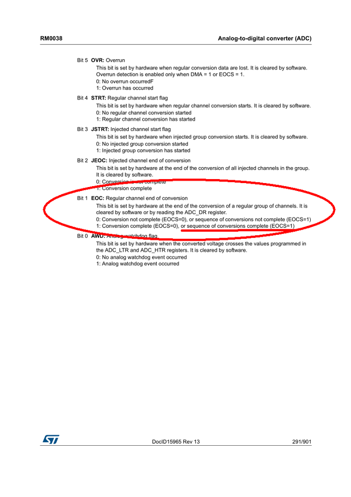

[EDIT] I don't use Cube/HAL. https://github.com/STMicroelectronics/STM32CubeL1/blob/5641cb07a1d78d7e9649d056136e513bb273fcca/Drivers/STM32L1xx_HAL_Driver/Src/stm32l1xx_hal_adc.c#L1196 maybe?
[EDIT2] EOCS value in description of EOC in the RM0038 section I've posted above appears to be wrong, can anybody please check me?
