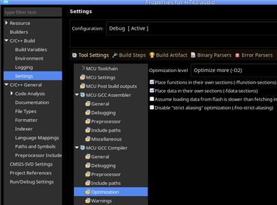

Ok, and what did you set as optimizer level ? If you want it fast, need -O2 or -Ofast , otherwise code is not at the expected speed, but good only for debug.
-> project settings
