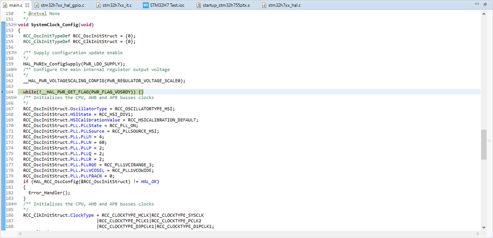

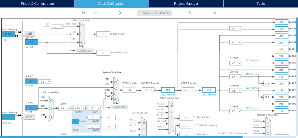

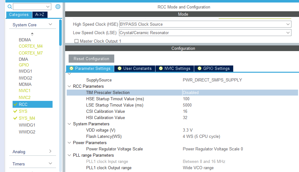

I'm trying to configure NUCLEO demo board at 480Mhz but I'm not able in any way, the following clock configuration seams to be correct, no conflicts
But the code will permanently hang on on the following configuration line
If I comment the line
while(!__HAL_PWR_GET_FLAG(PWR_FLAG_VOSRDY))all seams to work correctly, why?

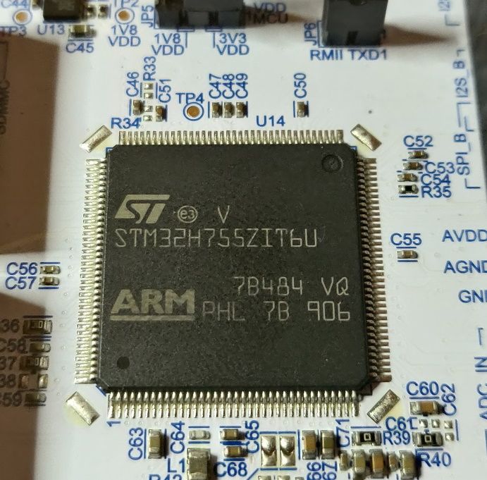

Chip revision seams to be V so It will be capable of 480MHz
What is wrong? Can someone post a correct clock configuration ? Is there a modify to the board to do? I'm using the last STM32CubeIDE 1.3.0 with H7 1.7.0 support library
best regards
GMG

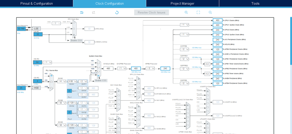

Hi, I think you may be right, now the problem is that I can't find a working solution to go to 480MHz using IDE configurator

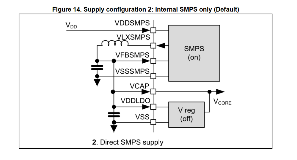

Board power configuration may be the default one as write in the user manual of the NUCLEO
Power Regulator Voltage Scale options can only be 0
The symptoms seem to be exactly those, but I don't understand how to solve it
2020-03-12 10:25 AM
The problem was in the IDE, I was selected LDO and not SMPS

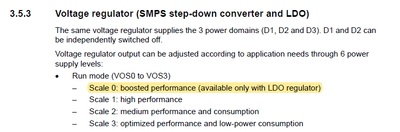

To all,
By specification VOS0 (480MHz max) can be reached only with LDO.
So no VOS0 with SMPS.
SMPS can reach up to 400MHz at VOS1:
Refer to the datasheet:
So with NUCLEO-H745ZI-Q the power configuration is SMPS => The max system clock is 400Mhz with this board except if you modify the board to be in LDO config.
